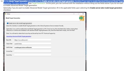

Hello @FC_12202090 , I believe you have already opened a ticket with us.
Is your Experience Service (ES) running behind a proxy?
Would you please confirm whether the Model target generation is enabled at the Vuforia Experience Service side or not as shown in the screenshot?
Please refer to the Vuforia Experience Service help center link for more details--> https://support.ptc.com/help/vuforia/es_install/en/index.html#page/ES_Install_Help_Center%2FThingServerInstall_ESInstall_Windows.html%23wwID0ENCLO
Feb 18, 2025 5:04 PM UTC
Hello @FC_12202090 , Based on the error that is showing up in the Studio.log.
Please also check the article --> https://www.ptc.com/en/support/article/CS342716?source=search
