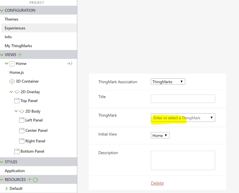

@danielrmendes Inside your Studio project, ThingMark associated could be checked from Project-> Configuration-> Experiences-> ThingMark . Also, make sure ThingMark widget has the same value in ThingMark property.  ( attachment 1)

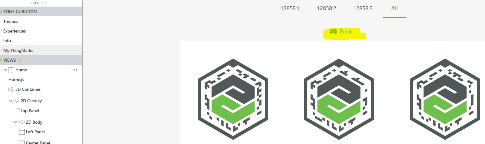

For printing ThingMarks in your Trial instance, click the print option inside My ThingMarks as highlighted below:
(attachment 2)
