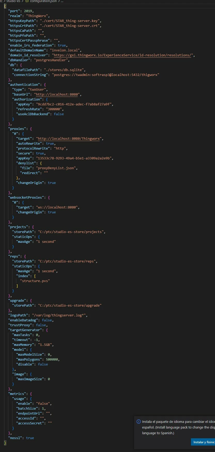

Everything is correctly setup, thingworx is up and working, followed the installation guide, but experience service ping not working.
http://localhost:2019/ExperienceService/ping - not working
http://invelon.local:2019/ExperienceService/username - not working
http://localhost:8080/Thingworx/Composer/index.html - working correctly
btw heres my C:\ptc\studio-es\configuration.json
sebbenAnswer

Sorry, this is just for sqlite db handler...
Maybe there is an error in your connection string. Is the database called thigworx or thingworx?
But usually you would get an error message when you start the experience service... But usually you would get an error when starting the experience service.
Is nothing else appearing in the command prompt?

is the experience service running as well? When you start it from C:\ptc\studio-es\start-es.bat you should also get the logs in that window.
Can you provide it here?

Hi thanks for the response, here are the logs. After running this bat, service still not working and closes itself, dont know if there are other logs to see if it crash or something.
May 24, 2022 6:41 AM UTC
It seems like it find the SQLite db file. Usually its at C:\ptc\studio-es-store\db.sqlite. Can you check if the file is at this location and change the path in your configuration.  "datafilePath": "C:/ptc/studio-es-store/db.sqlite"
