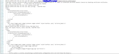

Hi all,
We are trying to install Experience Service with SSO authentication.
We followed this article - Install the Experience Service on Windows (ptc.com)
During installation, we got an authentication error message.
Could some one help me to solve this issue
/VR
January 23, 2024
What if you set: ["NODE_TLS_REJECT_UNAUTHORIZED"] = 1 ?
January 23, 2024
you could try the solution in this article: https://www.ptc.com/en/support/article/CS349346?source=search
  • Set the Environment Variable named NODE_TLS_REJECT_UNAUTHORIZED at the value 0
  • Obtain OAuth Access Token again and proceed with Vuforia Experience Service installation immediately after obtaining the token, because the access token may expire after a short period of time
  • Install Vuforia Experience Service
