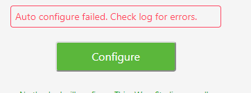

I tried to validate my experience service URL..but it is showing error..please help me to find the appropriate URL to fix this issue.

I am having the same problem. I am sure the issue relates to the fact that my pc is located behind a firewall and proxy. Is there any way to directly access a dashboard to obtain the experience URL to try and do this manually?
I also get the error
When I check my logs I see this
In the settings dialog where I can add the proxy is doesn't give me an opportunity to input the port number.
Is there any other place I can configure the proxy details?

matheswaran ramkumar​: Could you please share the Studio application log and confirm if firewall is not blocking your port/ES Url ? Are you able to validate the ES URL inside any project ?
Please try mobile/home network as there has been issue in past where organization firewall blocks ES URL.
