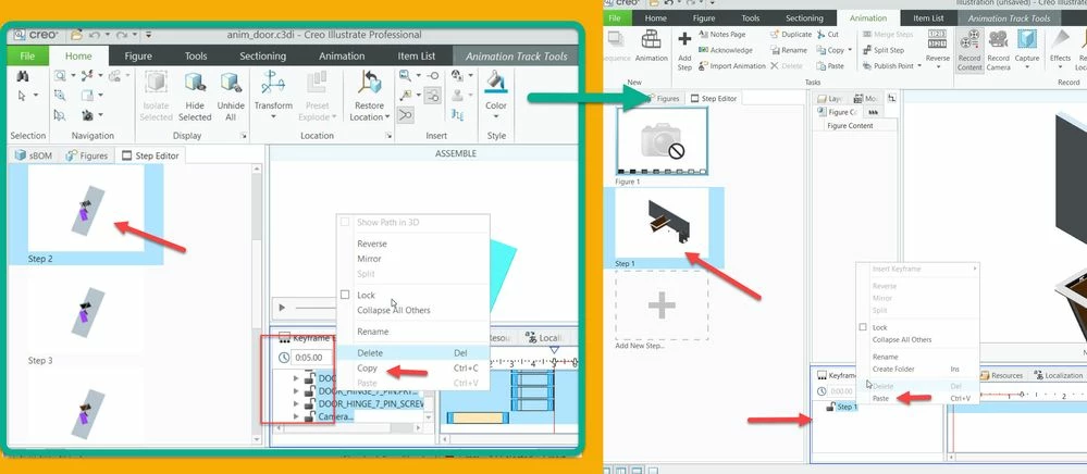

1.) but you can copy a step from one Creo Illustrate session to another:
2.) you can copy the Creo Illustrate file  c3di to another name and then change it by some Creo Illustrate operation like: copy a figure, copy a step, copy step to other figure, reverse the Step, reverse the sequence  ... etc. and save it into the new file. I think this will be the option I will prefer.

I must have a different version of Illustrate.  Haha.
There is no copy for a figure.  Only duplicate.  I can copy and paste steps within an Illustrate session but not between two sessions.  Paste on a step is grayed out when moving to the other session.
