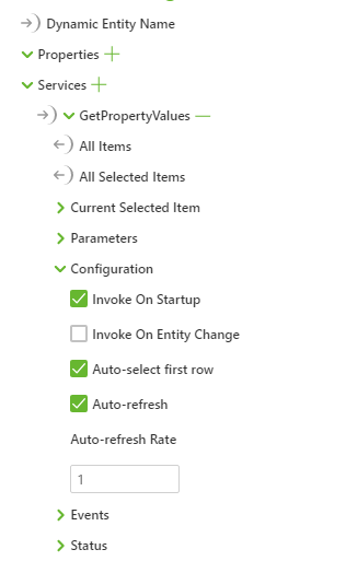

My experience should display live data from a connected thing from our thingworx server. I encountered several issues with the value binding and auto-refresh feature.
I managed to enable the auto refresh not by binding the property, but by binding the service method GetPropertyValues.
Then the property change triggered by hand with a value change in the Thingworx Composer was propagated and the value in the preview window was updated correctly.
However the issue remains with the published experience in Thingworx View app on IOS.
does not work in preview & and published experience
this works in preview but not in published experience
Any suggestion is very apprecciated

Yes! In fact there are
[context: com.thingworx.webservices.context.HttpExecutionContext@6f54653][message: Not authorized for ServiceInvoke on GetPropertyValues in.....]
I suppose this is because the experience is published unauthorized. I already found the section in Thingworx Studio (and the hint "For more information, see Configuring Public Access to ThingWorx in the Help Center."
but the link is broken
gbirnzain11-GarnetAuthor
11-Garnet
March 3, 2017
it works when I set the experience to "Requires Authentication"

So, it seems that either the 'Configuration Public Access to ThingWorx' is not there for your instance or some permissions are missing.
Could you please check that does a user named es-public-access and an application key with the same name already exist on your ThingWorx server?
Ankit Gupta
March 3, 2017
In addition to this; you must have created some entities i.e. Things with Properties & Services in ThingWorx. Did you provide visibilty and runtimetime permissions for these entities to es-public-access and the anonymus user?
[Not authorized for ServiceInvoke on GetPropertyValues in.....] indicates that permissions to the entities are missing.
