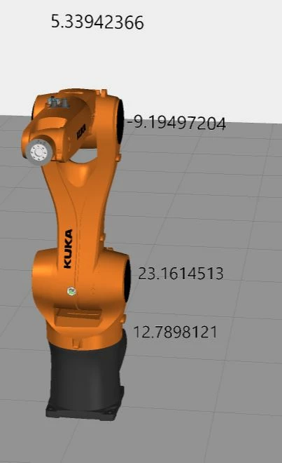

I made a Hololens application that uses external data from Thingworx for the experience.
When I click preview I can see the values (like in the picture).
However wehn I view the experience with the Hololens or with the Smartphone app, I can just see the name (Label:) but no numbers..
Any idea how to fix this?
Thanks!

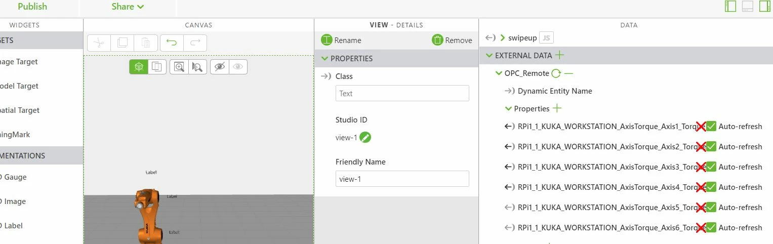

I forgot to mention, I binded the properties to the 3D lables (picture)
augmentor1-VisitorAuthorAnswer
May 2, 2019 2:00 PM UTC
Nevermind, I solved the problem.
Solution:
1) Set Access in Vuforia studio to "requires authetication"
2) Instead of binding the properties, go to services > getpropertyvalues > select the property and enable the configuration settings "auto-refresh" and "invoke on startup".
