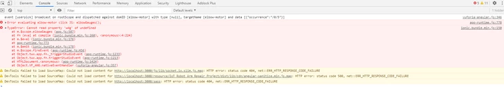

Hey,
What I am reporting used to work and within the space of roughly 1-3 weeks it no longer works.
I ran though the Fundamentals of AR Development course in PTC University and managed to complete the IoT Robot Arm Repair Project. The Project worked nicely where it was pulling IoT data from the RoboArm1 Thing on the ThingWorx Platform. For some reason now, the 3D gauge never updates with new values... Even though the service configuration is correct, see below
Any help please? Did the Vuforia Studio update affect this?

Hello Ryan Anderson,
In Vuforia Studio, in Preview when reproducing the issue, what is the output in Chrome, in Developper Tools, in Console tab ?
Best regards,
Samuel
June 23, 2020
Hey Samuel,
Here is the output:
BR
Ryan
June 23, 2020
Hello Ryan,
I suppose that the data is not updated to the javascript exception thrown.
The solution is to solve it.
I have some questions :
  • Do you have a custom javascript function named elbowGauges defined in <View name>.js node ?
  • In a 2D Widget with a Click Event, in this Event do you a call to a function elbowGauges(); ?
Thanks you in advance for your feedback.
Best regards,
Samuel
