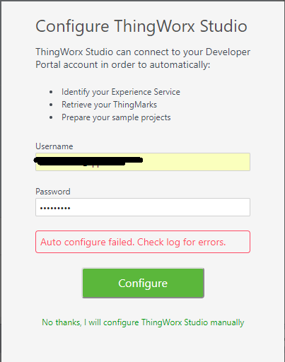

Aug 31, 2017 6:19 AM UTC
Failed to configure
Auto configure failed.
I have tried in my company network,public network.
Even I changed different account. WHY????

Hello  金龙 高,
Please confirm if the issue still persist and need assistance. Please share the screenshot of the error  along with details you are getting while doing auto configure to further assist you.

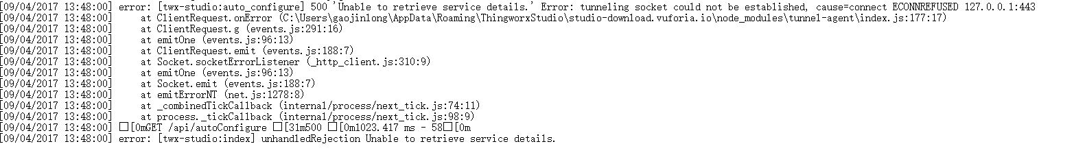

金高_011-VisitorAuthor
Sep 4, 2017 6:07 AM UTC
The issue still persist,and here are screenshots of configure window and log.
Sep 5, 2017 5:46 PM UTC
Just curious, as I find neither your email nor your username in our Trial participants. Did you register for the Studio Trial version ? And did you receive a Welcome Email from PTC?
Sep 6, 2017 2:33 AM UTC
solved!thanks !
