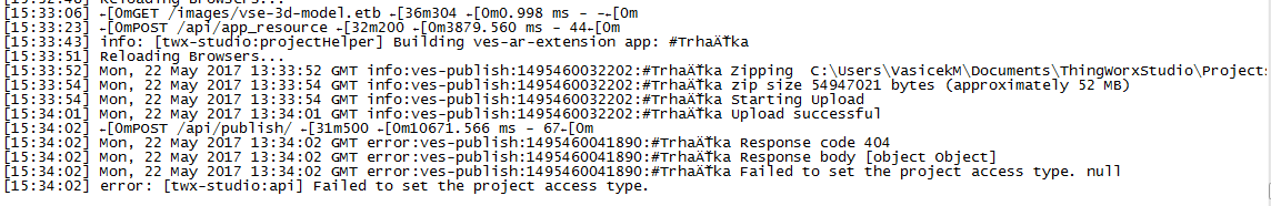

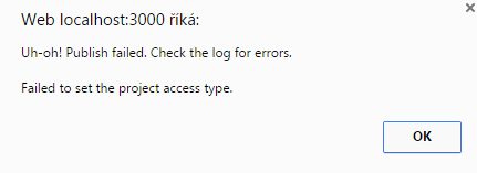

Failed to set the project acces type
Everytime when i want publish experience in Thingwory studio.
I can see this messsage.
Can you help me with it ?

Firstly, do you have the valid Experience Service URL (Studio configuration -> Info section)? Try to validate the URL and see if ES url is valid.

In addition to what Giri asked; Are you able to access the Experience Service url from a browser. And are you using any proxy for accessing Experience Service url?

I got the same error, any solution?

Are you able to validate the Experience Service URL as suggested in the above comments?
In the Project pane, click on Info -> Experience Service -> Click Validate

Yes,
It's only when I publish I get an error.
