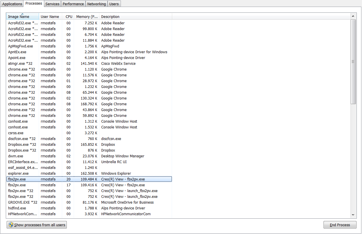

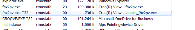

this is the error log extract:
ThingworxStudio Version:
Version 1.10 (0.1.14.1237)
with CAD Conversion:
taskmanager
conversion is running
20 to 25 CPU utilization
error after ~ 5 minutes
