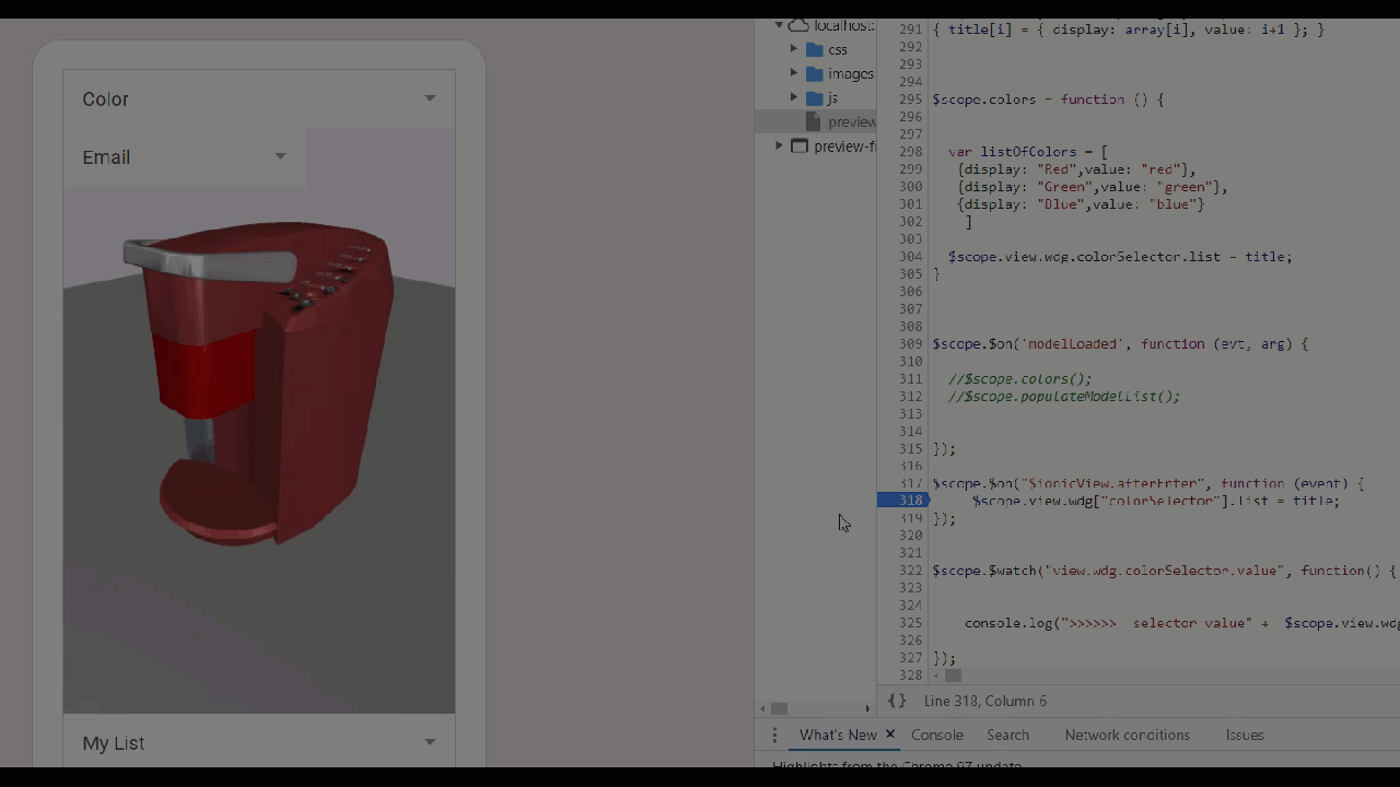

both approaches are working and your code show work - not sure what is not working for you
$scope.colors = function () {
        var listOfColors = [
              {display: "Red",value: "red"},
              {display: "Green",value: "green"},
              {display: "Blue",value: "blue"}
        $scope.view.wdg.colorSelector.list = title;
$scope.$on("$ionicView.afterEnter", function (event) {
$scope.view.wdg["colorSelector"].list = title;
// or
$scope.$on('modelLoaded', function (evt, arg) {
     $scope.colors();

Jan 17, 2022 7:50 PM UTC
// or
     $scope.colors();
