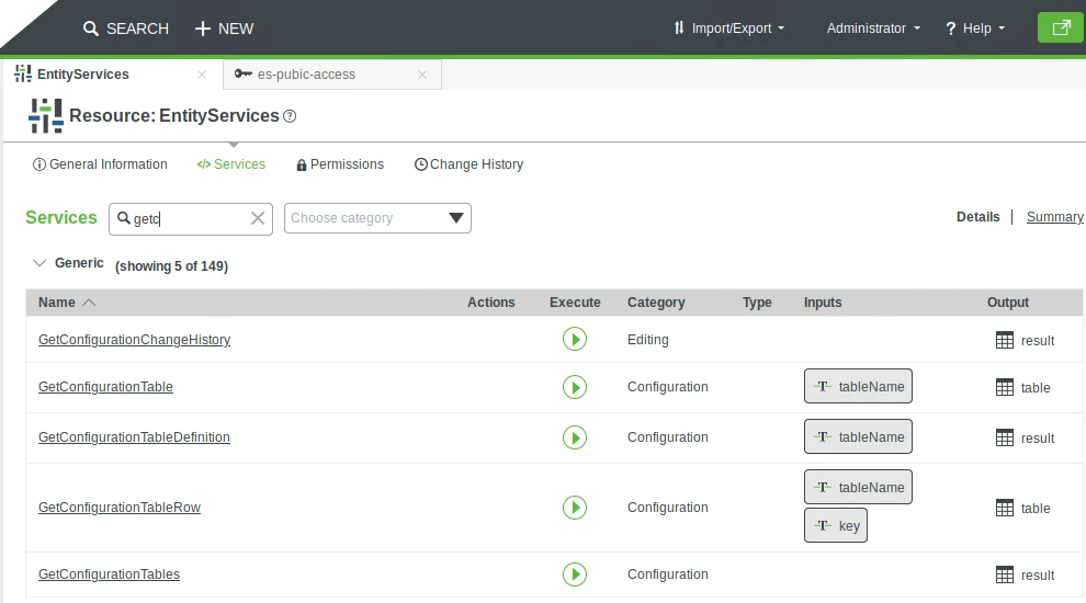

I have existing Vuforia experience service tied to my old Thingworx instance. I want to link the existing experience service link to a new Thingworx instance. Now I am configuring public access according to installation manual page 88.
Problem is that, I cannot find GetClientApplicationKey service in EntiryService entity. What should I do? My thingworx version is 8.5.0. Thanks.

Hi @RolandRaytchev ,
Thanks for reply. I tried to find GetClientApplicationKey but I could not. Although Vuforia service can be started, I could not see real-time value from thingworx on public experience.
Rather than troubleshooting, I installed Vuforia Ex service from scratch by installer and now my Thingworx instance show exactly same as yours. Now my public experience is working fine.
It is strange and it seems to be we always need to go with clean installation from scratch.

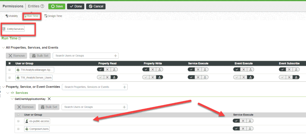

Jan 17, 2020 10:02 AM UTC
Hi @Toshihiko ,
I checked on my Experience Service installation -  checked the thingworx instance  and I also was not able to  find this service there (GetClientApplicationKey).
But my instance was working fine also for public experiences. So I checked it and when I go to the permission I could see that this method was set- my be from the ES installation. Could you, please,  check as Administrator for the resouce EntityServices >Permissions> Runtime if you ths service is already set :
