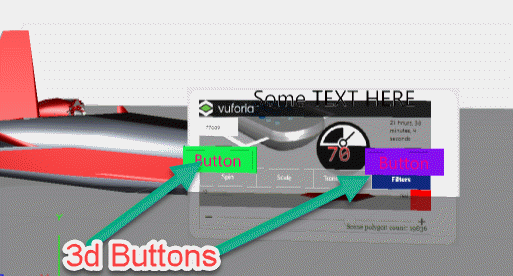

so far I know, it was not possible in generally possible to do this because  the HoloLens does not support 2d elements - means also the IsonicPopus. I checked first if in the meantime the functionality change but seem still it does not work also in the current version. The IsonicPopus  will work in the project preview, because the chrome and the Vuforia studio thingview support 2d elements for mobile 2d and 3d -  but on end device HoloLens it will not  work. I could also confirm this behavior after test by myself (with HoloLens 1 device)  when I test it that in preview mode Ionic framework is shown / e.g. the alert popup/ but this will not be called when you try this on the HoloLens device .
What we can do?
I think we can use a 3d Element instead which should implement the dialog.. For example, 3D Image which displays your dialog / you can use a picture or can generate it dynamically as SVG file format.
The different buttons you can play  e.g. in front of the 3d image on some small distance so that you will be able to tap on it

I understand your alternative solution with 3D images, but to my understanding are they be placed firmly in the users view (e.g. as 2D popup will be), which is what I am looking for.
Using a 3D image will require you to place it exactly where you want the user to be, which can be problematic if you are moving around in a certain area, which is why the Ionic popups where perfect for the task. Are there any way to get 3D images fixed in the user field of view no matter where they are?
