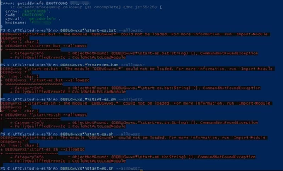

What could the reason be and where should I check

@Aparna  Could you please start the ES using below debug mode command and review error-
DEBUG=vxs* bin/start-es.sh
Also, make sure the port used by ES is not already in use.

Hi! How exactly the command will look like?
May 20, 2021 7:00 PM UTC
Could you please provide your OS details on which you have installed Experience Service. Is the installation completed successfully or have you noticed any errors post-installation? Have you started ES in debug mode? Please review the below article to start ES in debug mode. This will provide us more information on the issue:
https://www.ptc.com/en/support/article/CS292811
