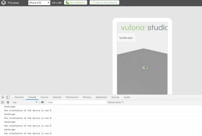

I am attempting to get change the text of a widget based on the mobile devices orientation. From what I could find, the best way to do this is via Javascript. The CSS methods I found for finding orientation are quite easy, but changing the text content of a widget via CSS is another story.
I found a solution here, and have tested that using the "Studio Sample - Import 3D Data" project that comes with vuforia studio. The only thing I have added is one extra button input widget, and some Javascript code.
When I test it using a preview feature in vuforia studio, the button text only updates once. The console continually rewrites the same orientation each time I change the preview orientation or the preview screen size.
I also tested it by publishing this app and running it on an iPhone using Vuforia View. Here is gets a little better.
But It appears the experience needs to see another event, beyond orientation change, to push the button text change. For example, if I switch the iPhones orientation, my button text does not change, but once I touch a different button, say the Rotation Toggle button, the text on my Button-1 widget updates.
Any advice?

CliffRice1-VisitorAuthor
March 31, 2020
@sebben that just might work for my specific issue. I have some javascript tied to the button on my real experience, so I will need to see how that affects things. great idea!

Hi @CliffRice ,
yes the mention link in your post could be used only on start- but it will not detect a dyncamic change - e.g. rotate the device. For me I used a soluton which was working in preview and in android. Possibliy it works also on IOS, but I did not test it there. ON HoloLens it is only landscape mode - so far I know.
I used the following code:
angular.element(document).ready(function() {
 angular.element(window).on('resize', function(evt) {
 //console.log("resized window evnt :");console.warn(evt);
 var message = ''
 var win = evt.path[0];
 if(win.innerWidth > win.innerHeight){
 // LANDSCAPE -> do something here call your landscapeFunc()
 message = "current orientation is Landscape!"
 else {
 // PORTRAIT -> do something here your PortraitFunc()
 message = "current orientation is Portrait!"
 twx.app.fn.addSnackbarMessage(message,"twLogo");
 We need to pay attion here that we are in angular js environment . I think the windows variable is static an is passed on system start - therefore it will not update dynamicaly.
