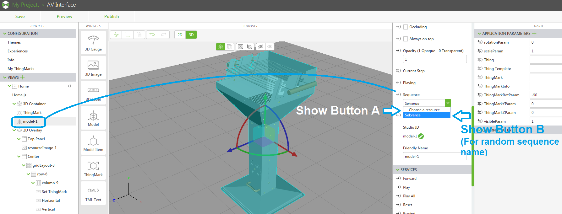

I want to specifiy if the model has selected a sequence.
For example: If yes > show button A, if no > show button B.
I tried different ways, yet without success.
Thank you!
Best answer by TomasCharvat
Hello Lily,
I solved it today. Function decide base on model widget parameter steps ​which is undefined when model has not a sequence (otherwise parameter is a number).
$scope.selectButton=function(){
  var pom = $scope.view.wdg['model-1']['steps'];
  var ButtonA = false;
  var ButtonB = false;
  console.log(pom);
  if (Number.isInteger(pom)){
    ButtonB = true;
  else{
    ButtonA = true;
  $scope.view.wdg['visibility']['visible']= ButtonA;
  $scope.view.wdg['sequence']['visible']= ButtonB;
The function is started when thingmak is tracked.
Best Regards,
Tomas

August 8, 2017
Hello Lily,
thank you for fast answer
Is possible to make decision base on model widget parameter "sequence"?
I tried to write function in Home.js which make this decision immediately after start.
This function should read value from parameter sequence I don't know the correct syntax. Then IF - ELSE will make decision based on sequence value.
I tried something like:
(function onStart(){
  if ($scope.view.wdg['model-1']['sequence']==""){
    setWidgetProp( 'visibility', 'visible', true);
  else{
    setWidgetProp( 'sequence', 'visible', true);
Thank you,
Tomas
