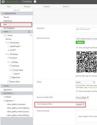

When I click the hamburger button in the header, it opens a side window with a Menu that only contains the word Home and all I can do is open and close this window. How do I edit this space to add/change the content in it and possible change the behavior (JS functions, buttons, text, etc). If I can't modify this space, is there a way to use the header but remove the hamburger button?
10 replies
Sep 5, 2019 8:20 AM UTC
This side window menu list all Views created in the Experience.
We cannot change it to add space or something else.
It is still possible to hide it and to create a custom menu to navigate in the Experience.
Steps :
  1. In Vuforia Studio, in the Project,
  2. In PROJECT panel, in CONFIGURATION section, in Info menu
  3. Switch off the View Navigation Menu checkbox
