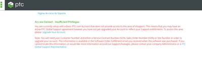

The detail is that it does not give me access and I have in mind that there is an option for a free trial
Dec 13, 2024 2:42 PM UTC
Hi @MS_9601516 ,
unfortunately the trial option was retired still 15 May 2022 and is not provided by PTC any more. The announcement was the Vuforia Studio comminity on 12. April https://community.ptc.com/t5/Vuforia-Studio/The-Vuforia-Studio-Free-Trial-is-Retiring/m-p/789775#M10752
Possibly you  can ask if you have some a contact person of PTC presales or Sales or  PTC partner so possibly they could add an  user account for some tests on their server on the PTC cloud portal or if they on premisses server installation.
