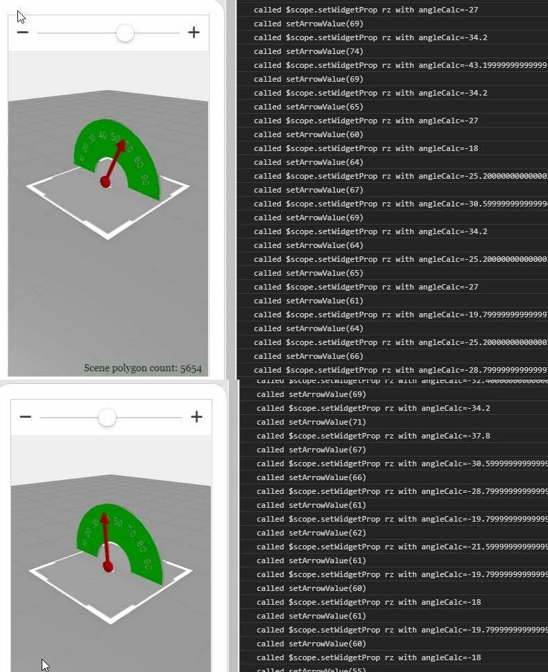

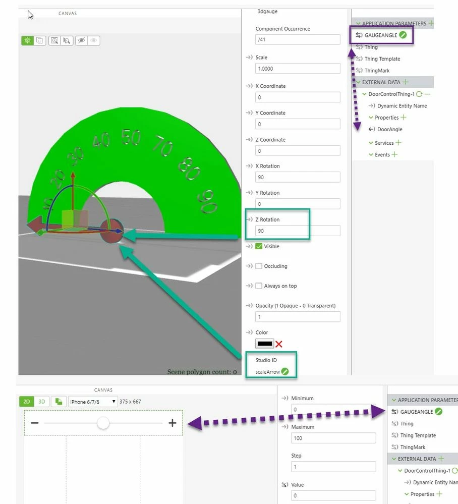

Nov 8, 2019 11:57 AM UTC
Hi @ifadeev ,
here I attached a small project (attached)  which used similar approach to the mention "Gauge moving indicator" but instead of 3d gauge I used a simple 3d assembly where the arrow is a component used for modelItem  definition:
Here I used a 2d slider widget to set the app parameter for testing. But I also attached here (it is relevant to my environment only) to a Thing property "DoorAngle" and it worked fine.
I used the following javascript&colon;

Then I tested it in the preview:
I attached the project to this post and hope it could be helpful in your case.
