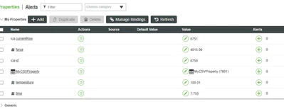

I need help with creating a 2D time series chart in Vuforia Studio. I've looked around through the other community posts but I am left mostly confused by what data needs to be bound with the chart. I have 3 properties, that are split from a infotable property on thingworx as shown in the screenshot below:

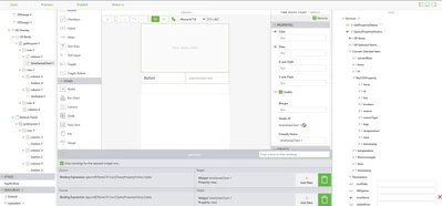

And I've tried dragging the QueryPropertyHistory data to the chart, but my chart data does not load.

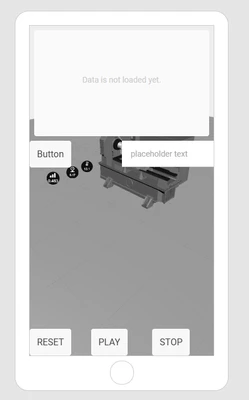

So I am just confused about how to get my data displayed on the chart. I will attach an screenshot below of how it looks in Vuforia studio:

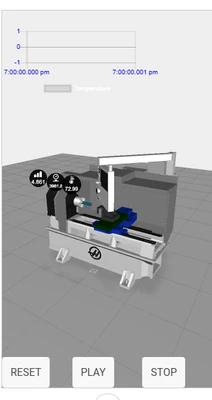

I've tried to follow that guide, but the most I can get is this:
This doesn't display the data and only happens when I export "All items" from GetPropertyValues, additionally, I am not getting any drop-down items for the x-axis and y-axis names.
