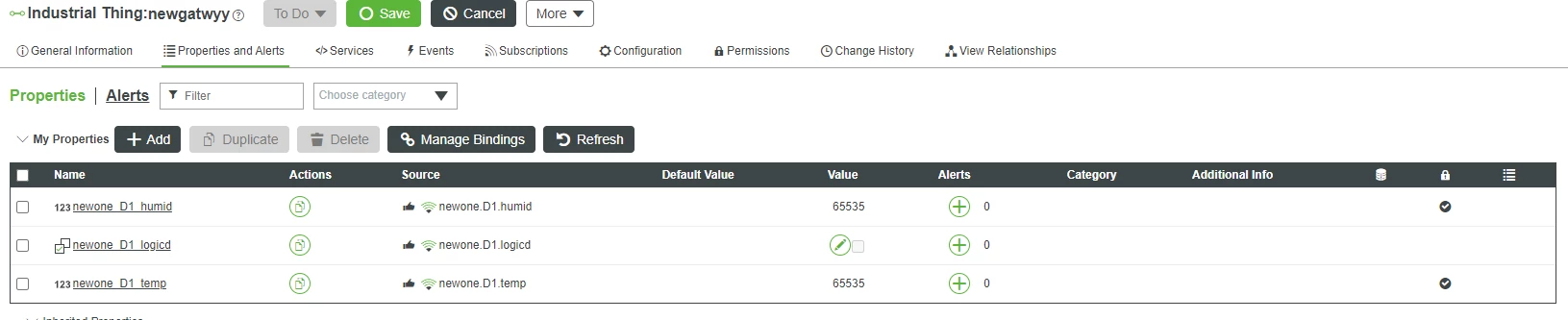

hi i need to switch on a led by using the button / checkbox
Hi i have interfaced the led with the thingworx and i'm using its prop in vuforia studio for the temp and humid values. I have the values but, i'm not able to switch on/off the led from vuforia studio.
Kindly help with the code or suggest me with the changes that i need to make.

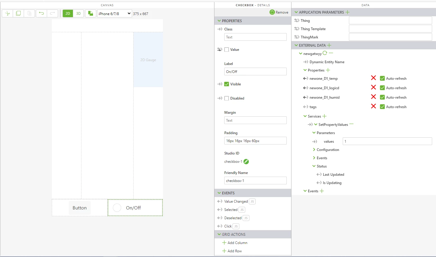

I'm attaching the screenshots below for your reference.
Jan 8, 2022 12:42 AM UTC
Looking at your studio image I don't see a binding to the setpropertyvalues this could be your initial issue
Although I would implement it differently
I would build a wrapper service to toggle the led
For example create a Thing called PropertyHelper and create a service called ToggleLED that sets the value of the newgatewyy LED property from the parameter supplied by studio
Set the toggle button to send true or false to the the ToggleLED  service and use the click event and bind the service ToggleLED

Jan 21, 2022 9:18 AM UTC
u need to push the vuforia studio data to thingworx
