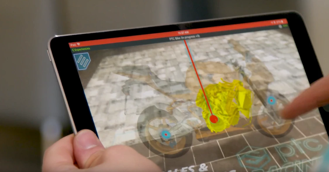

I am trying to achieve functionality similar to the vuforia studio motorbike welcome experience. I want to be able to press a 3D image button, and have a section of my 3D model highlighted a different colour. There are three different sections that I want to have their own button.
