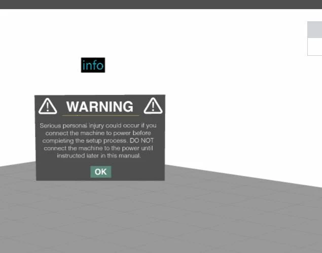

The HoloLens by design does not have a 2D panel. This is a limitation of the HoloLens itself. You can utilize 3D images and 3D labels to get the same effect of popups or menus.
Here is an example of using a label as a 'button' that opens the 3D image Warning popup/menu.
