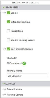

In Studio, you used to be able to control the Near Clipping Plane and Far Clipping Plane distance on the 3D Container widget.  The help files say that the option is there, but not now (Studio 9.2.2.5162):

I checked the current information’s available  - the internal articles DT-19522 (mentioned in your post) but there is also DT19502
"The clipping plane properties are no longer working/supported with ThingView/ or the HoloLens renderer “
So that it results that the  Clipping Plane properties from 3D Container are hidden and the 3D Container widget  does not display any "Near Clipping Plane" or "Far Clipping Plane" property
The build was 8.3.6
Here I will check why still there is info in the help - possibly the help should be updated.
