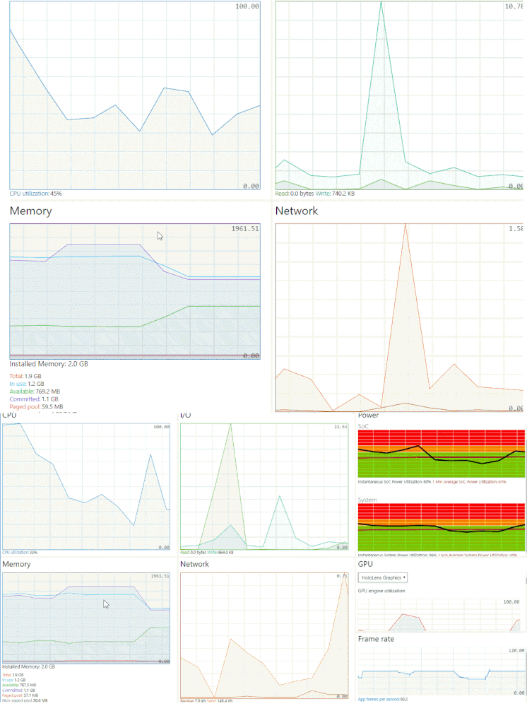

I encountered a problem with the latest version of the View app on HoloLens after the update to 8.4.1 came late last week.
I had an experience created that used a textured model created from an FBX file.  The experience was working fine on the HoloLens using View 8.4.0, but after the update to 8.4.1, the view app crashes out when loading up the model Smiley Sad.  I had to create a new version of the experience that doesn't have any textures and that loads up fine.
This happened on 3 different HoloLens's all running the latest version of Windows and 2 of them have been recently reset with nothing on them apart from the View app.

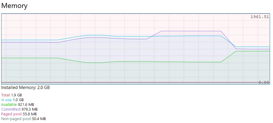

It's not a memory issue as the performance graph from the device portal shows.  You can see the the loading, and then the plateau when the app crashes and the drop when it exits out of view which is still way below the memory limit:
It's not a global problem, as I have other experiences with textures that load up OK.  Attached are the QR codes for the two versions of the experience - with and without textures.  Unfortunately, I can't go back to the older version of the View app to try again.

so tested the 2 QR codes  GT_HoloLens_shareQR.png  - here could reproduce the chrash of the vuforia view on the Hololens
the other QR code GT_HoloLens_No_Textures_shareQR - works fine  - but I see that this model seem to be complex.
I have  Vuforia view 8.4.1 build  197. What was the datecode where are able to load the project QR code GT_HoloLens_No_Textures_shareQR ?
Seems to be there are  peak of the memory and network usage but I was observed  also such behavior when I am testing features which are working fine.
Could you reproduce the issue also with models having texture with less complexity?

Unfortunately, I can't tell you the exact build version of View that I was running that worked with the textured experience, but it's the version that was available on Wednesday last week from the Windows Store as I had to install it on two of the three HoloLenses that I was using for the first time on Wednesday.  On Friday morning my time, the new version was available, and I updated the third HoloLens with this version and started having the problem.  Then on Saturday the other two must have updated automatically (I don't own them or have them now) as they also started having the problem.
I've tested some other models that use textures and these are working fine.
While I agree that it's a relatively complex model for the HoloLens, the issue is that the experience was working fine in the 8.4.0 version of View and then after updating to 8.4.1 - something that unfortunately you can't control on a Developer edition of the HoloLens, the same experience crashes out every time when loading.  And looking at the memory trace on mine, it crashes out before it even maxes out the RAM usage.  Maybe it tries to load the textures and it fails as there's not enough available RAM?
