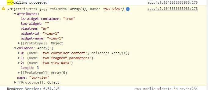

Hi @GianVal ,
you can use the mentioned technique also to load the Home.json. It is only a different path what could you  check in the project folder - e.g.:
 let my_file='Home.json'
 $http.get('app/components/' + my_file).
 success(function(data, status, headers, config) { console.log("-->calling succeeded");
 let myJsonData=data;// in this case is $scope.modelData['model-1']='Info.json';
 console.warn(myJsonData);
 .error(function(data, status, headers, config) {console.log("-->calling failed");
This will print the Home.json to the console in preview mode. e.g.:

GianVal15-MoonstoneAuthor
Mar 17, 2022 8:46 AM UTC
Hi, I'm using this method to read an external JSON file. How can I use the retrieved file in the whole code as a "global variable"?
e.g. read a json-> get a JSON element to use in another function
Many thanks
Mar 17, 2022 9:00 AM UTC
without the check more detailed I think the following options could be used
  1. - in case that you will not change the json content you can load this json file each time you go to Stuidio View.
  2. - set the value to applicaiton parameter - so possibly you need to use JSON.stringify() and JSON.parse() when read and save there
  3. - use some of the available in Studio widget as container to save as text ( (e.g. unvisible or use  the text of tmlText widget etc) here is the same - so possibly you need to use JSON.stringify() and JSON.parse() when read and save there
  4. -or create an customized widget which should be container only
  5. - use some TWX method to save the content to an repository and load later from repository
