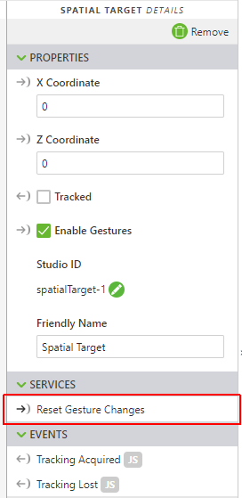

I have a spatial experience.  when the experience is viewed, the model is inadvertently scaled.
I'd like to add a button to reset the scale back to 1 or better yet, lock the scale.
any thoughts?
Best answer by AllanThompson
I just realised the answer.  For a spatial tracking experience, create a button or something that when I click, it binds to the Spatial Target and use the reset gesture changes service:
This is in the Spatial Tracking example that comes with studio.

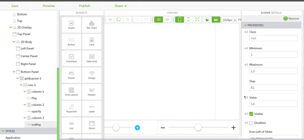

Hi James,
Following is one of the ways to scale the 3D model using a slider widget:
  • Click on 2D canvas, drag the slider widget on to the bottom panel and set the desired minimum and maximum values in the properties section of slider widget as shown below:
  • Also, set the default value in the Value field (for example, set it to 1).

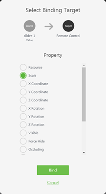

  • Now bind the value property from Slider properties section to the model in the VIEWS -> Home -> 3D container->{your 3D Model} section and select scale option in the properties field as shown below:
  • Save and Publish the experience.

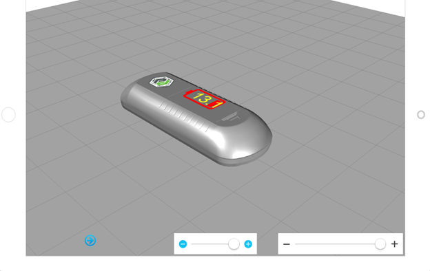

  • In the view, scan the ThingMark and notice a slider bar in the device. Now, slide the bar to the desired value as shown below:
Please let me know if this is what you are looking for.

Thanks for your reply.
This works great for a thingmark-based experience, but for some reason, not for a spatial experience.
I added a slider widget and bound it to the scale of the model, but when viewing the experience, it has no affect.
Ideally, I'd like to lock the scale, or add a button, that when pushed, would reset the scale back to 1.
thanks for your help.
