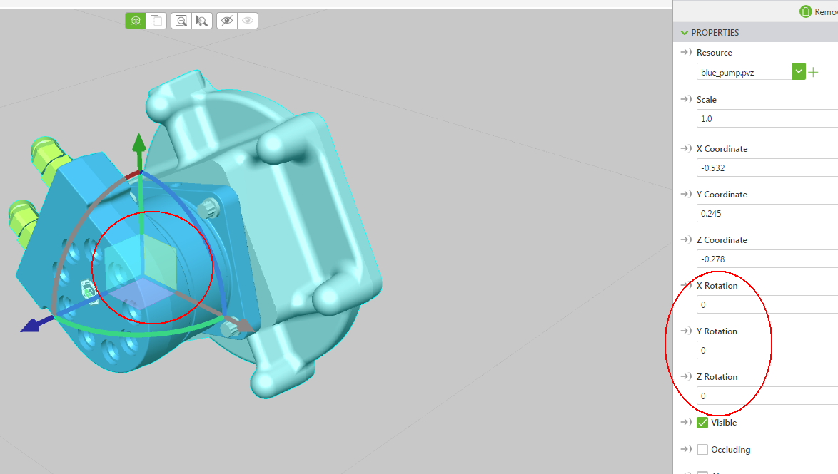

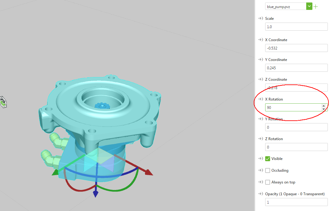

when i import a  pvz model into studio, i am always confused about the coordinate system. when i change the "X Rotation" to 90 °, the model turn pic1 to pic2.  i don't know where is the the origin of the coordinate system.  but when i drag the coordinate system show within the model and rotate the model , it works well and  behave as I expected( the origin point of the coordinate system is clear ).
微信图片_20170620180115.pngp1
微信截图_20170620180108.pngp2

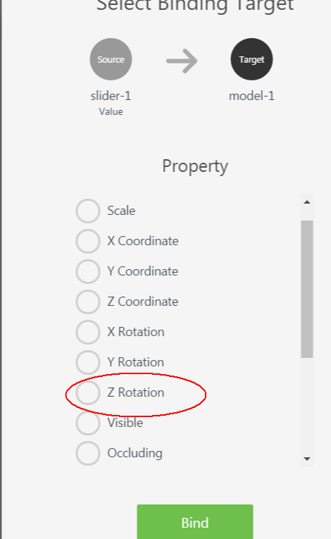

another problem, when i binding the 'slider' value to "X Rotation" property of the model(pic3), the model will rotate not as i expected.
微信截图_20170620181915.pngp3

Can you please share your expected behavior when rotating around the X axis?
I get the behavior you described as well. It is because we are rotating 90° with the X axis being the "spin center". If you notice in your screenshots, the X axis is the red line with an arrow and when you rotate your model 90°, the model rotates around this line. The transform tool is color coded to represent each axis. You'll notice that there is a red arrow and a matching red arc that represents the X axis. By dragging the model using the red arrow, we can move the model along the X axis while moving the model using the red arc, the model will rotate around the x axis.

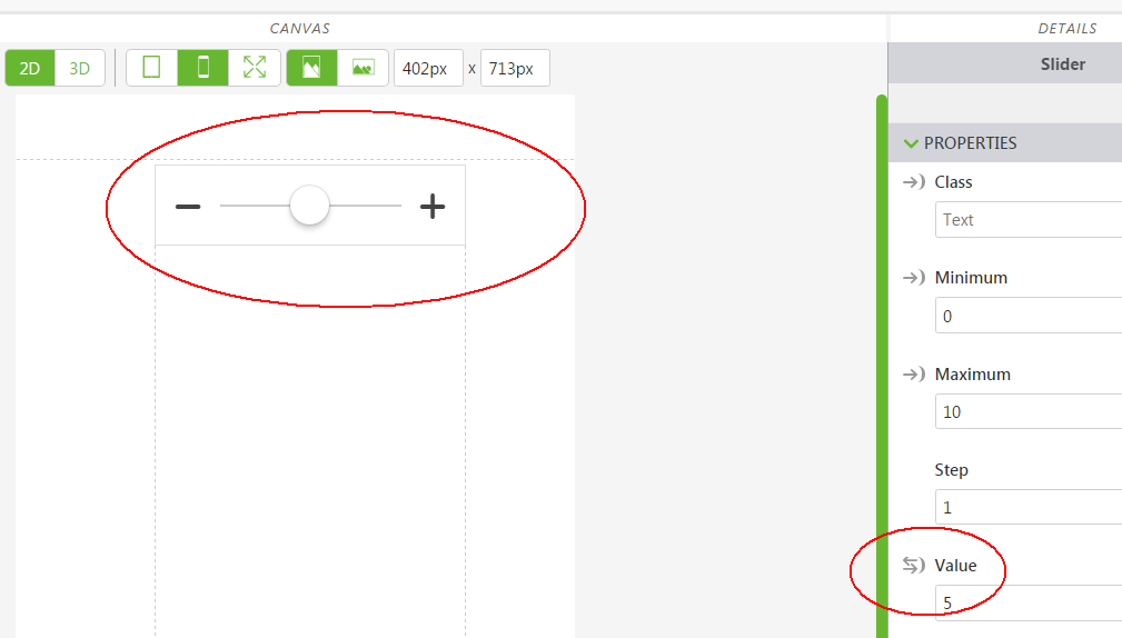

hi Tara , thanks for your shearing. I understand your description.  in twx studio edit page , we can rotate and translate by drag the 3 colored  arrows and arcs to make the model change as we expected.
but in TWX View app, If i want to rotate or zoom out the model, firstly i have to set up an “slide button” in 2D(pic1) and binding the widget ‘s value to the model in twx studio.
微信图片_20170621120222.png p1
At last, in View app ,when i change the slide button value to rotate or zoom the model, the model will rotate around the “unknown” coordinate system instead of the one showed in edit page of TWX studio.    As u said, the model is rotating  with the "spin center".  so where is the "spin center" exactly?   how can find the  pvz model's spin center?   this problem confuse me  for a very long time.
