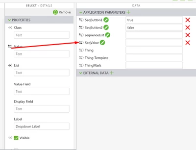

The current Status looks like this: We have 2 Objects in the 2D-Widget List
2D-Widget List2D-Widget List
Item 1 has a own Sequence and Item 2 has a own Sequence. Both have about 5 Steps in total.

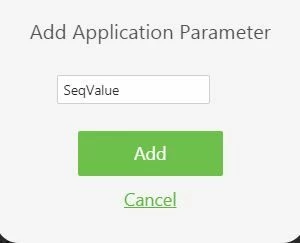

One of the ways to implement this scenario is as follows. I have used the Select widget to display the sequence list.
  • Create an application parameter by clicking + next to Application Parameters -> Type any name (for example, SeqValue) in the name filed as shown below:1.JPG
  • Drag and drop bind icon of the select widget value property onto the application parameter SeqValue as shown below:Screenshot_20.png
  • Update the if condition on the changeImage function as follows:
    • if ((step == 3) && ($scope.app.params.SeqValue == "app/resources/Uploaded/app/resources/Uploaded/l-Creo%203D%20-%20Item1.pvi))
Hope this helps!
