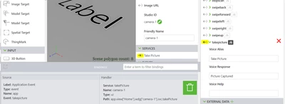

Hello Everyone,
I am developing an experience for hololens 2 where I need to take a picture using a voice command and the way I would like to do that is using the application events because I am using those for others functions.
In that way, I am trying to write a function and call it from the application event but no success so far.
Any idea on that?
Many thanks,
Felipe Duarte

Hi @fbdsilva ,
Is it possible for you to share the project, and maybe then i can look into it what's wrong or may be understand more clearly what you want to achieve
Also, as you mentioned, the issue is how to write the function to take the photo, you can use the below code
twx.app.fn.triggerWidgetService('camera-1', 'takePicture');
I Hope this helps, thanks

Hello @fbdsilva ,
As far I can understand from this, you want to use application event to take picture and at the same time want to call a function
For this, you can do the below bindings:
Write the required function and call it as the way shown below :
Attaching a sample project for the same, let me know if this is what you were looking for
Best Regards,
Mohit Kabra

Hi Mohit,
Thanks for sending this but my issue is not how to write a function and call it from an application event, I am doing that for many others functions, the issue is how to write the function to take the photo because as you sent others type of functions works fine but a take picture event is not triggered from the application event.
Any ideas?
Thanks again,
Felipe Duarte

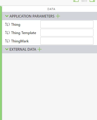

Hello @fbdsilva, @Mohit_Kabra27,
I wanted to ask you, In my vuforia platform, application event is not showing. What should I do? Here I attach file please check this. Do you have any idea about this or anyone knows please tell me.
fbdsilva10-MarbleAuthor
Nov 8, 2022 3:02 AM UTC
It is because you are not connected to any Thingworx server.
