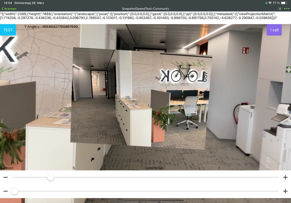

yes this possible. At least I verified that this is working on mobile platform - tested in Vufuria View 9.18 iPad pro  and it tooke a photo nearly without dealy. On Andorid - I have very old device for testing the daly was longer- Vuforia View app 9.16
I did not use the Camera widget but the  tml3dRenderer.takeScreenshot() api . So following example:
var callback = function (pngBase64String, args) {
$scope.view.wdg.photocapture.src='image/png;base64,' + pngBase64String ;
$scope.view.wdg.text.text = args;
$scope.$applyAsync();
$scope.screenShotPar = function() {
//let params = { dataURL:true, withAugmentation: true, imgFormat: "jpeg", imgWidth: 500, imgHeight:500}
//let params = { dataURL:true, withAugmentation: true, imgFormat: "png", imgWidth: 500, imgHeight:500}
let params = { dataURL:true, withAugmentation: false} //I do not what to see the agumentation in this case
 tml3dRenderer.takeScreenshot(params, callbackfnc, null);
$scope.testCall1=()=>{
$scope.firstcall=true
 $scope.screenShotPar();
So on iPad device :
The api should be also availible on HoloLens 2 but I did not test it how is the behavior there. The best result I had on mobile iPad pro with 9.18 Vuforia View app.
So here the demo  project if you want to test this.
