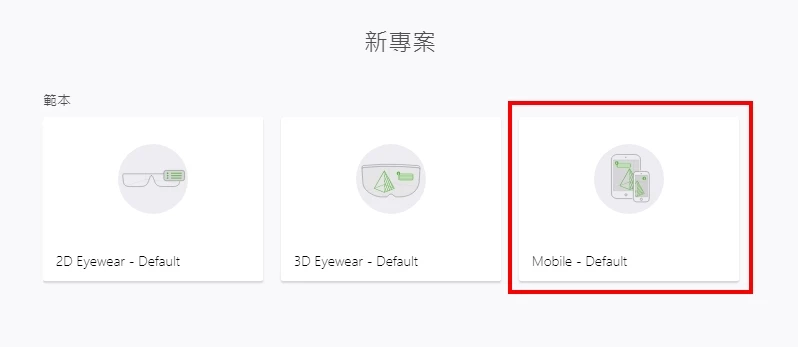

Hello comunity,
I want to add 3D Video to Mobile project of vuforia studio.
However, the search result in the community, the reply in this article
https://community.ptc.com/t5/Vuforia-Studio/Is-it-possible-to-add-a-video-into-the-3d-plane-If-so-how/m-p/502718#M2984
which answer  that the 3D video cannot be added to project.
However, in fact, in "3D Eyewear" project supports 3D Video. So, I would like to ask if the Modbile project can also support 3D Video function, or can I use other functions to add 3D video, such as tml text?
My vuforia studio version is 9.3.3.5491.

Hi @Bill_Wang,
I'm afraid mobile doesn't support 3D Video widget - If you publish a 3D eyewear project with 3D video, load the experience using your mobile View, you should see the 3D video doesn't show up.
You can switch to 2D view in Mobile project and use 2D "Video" widget.
