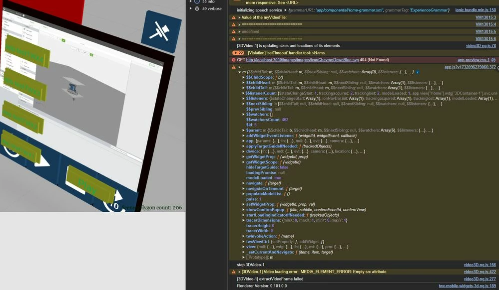

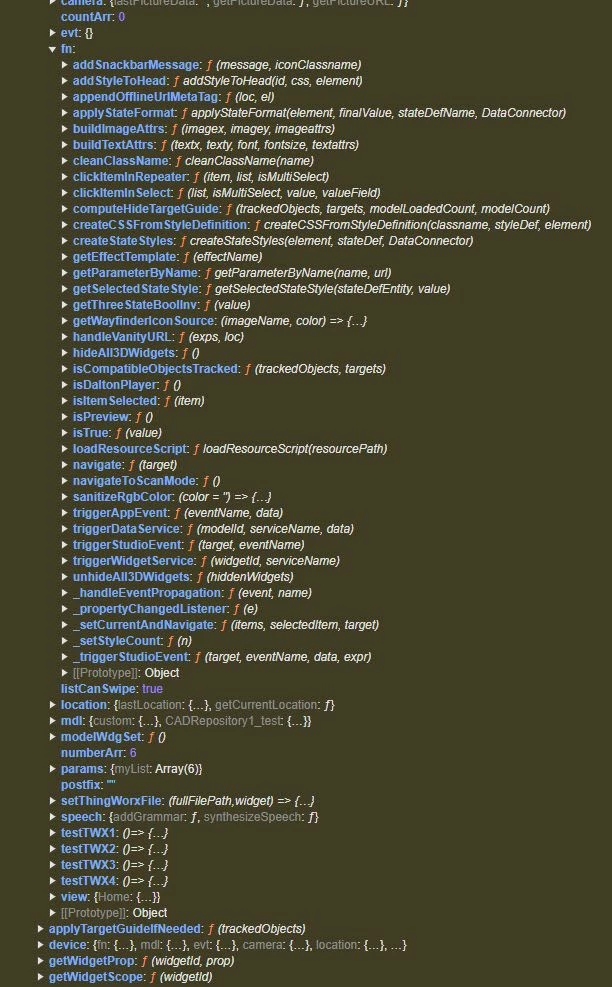

So printing the scope e.g. :
angular.element(document).ready(function() { console.warn($scope);})
and then in preview checked in the Cntrl+Shift+I debuging console check the $scope but the printing does not contain such function :
also checked the $scope.app.fn object
here also could not find any function with that name by default function of eyewear project.
