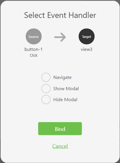

How do we bind a functionality with a button for which onClick of the button goes to another view of the project in Thingworx Studio
I have scenario where in there's a pop up display having OK button, on click of this button takes me to another view. How can I do this?
tmccombieAnswer
Dec 13, 2017 7:42 PM UTC
Hi Vaishnavi, You can drag and drop the Button's click event to the view you'd like it to navigate to. Then select the 'navigation' option. This will bind the button's click event to that view's navigation.
tmccombie21-Topaz IAnswer

Thank you for the info.
