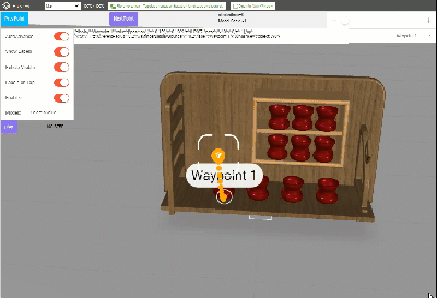

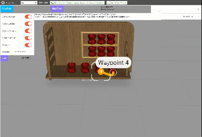

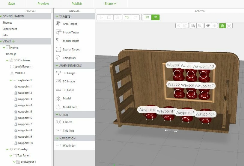

I have an issue with Waypoints. I work on one 3d model in Creo Illustrate and Vuforia Studio ( I don't add any extra parts ) and I don't change the actual location for my 3d model in animation. The only change in my updated file is an extra figure with fading or flashing parts.  If I add an extra figure to my sequence and then import an updated file to Vuforia Studio and then reopen Studio project my waypoints are moved to the wrong location and I need to put them back one by one.
My project contains ~15 views with wayfinders ( 25 waypoints on each). This is a lot of extra work for little change/update/ progress.
This is what happens with waypoints on my screen.
1- before re-uploading 3d file to VS project
2 -after reuploading 3d file and reopening my Vuforia Studio project
Please advice solution that will help me to keep the waypoints on same location after updating and reopening the Studio Project.

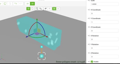

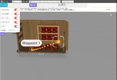

@sgreywilson I have made another test.
My offset  values are the same before and after I change the file in Vuforia Studio- and (!) I don't have any issues with waypoints dislocation. My problem occurs after I restart the Vuforia project ( close and open again) .
1 _ my project before I change 3D file.

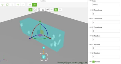

2_ my project after I change 3D file

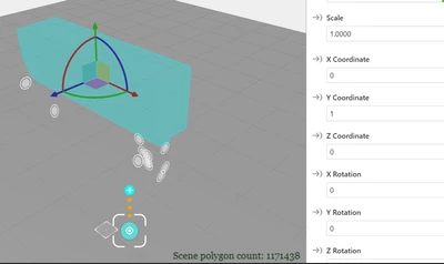

3_ my project after I closed and opened again my project
I have issue only when I reopen project.
Oct 25, 2023 2:09 PM UTC
When issue is occurring only when you reopen your project there is currently an issue fixed in 9.15 where some modelItem are set to zero. If  this is the issue you need when you observer the problem to Cntr-Z , or to call UNDO arrow so possibly this will fix the issue if it is the mentioned problem 2023-10-25_16-08-39.jpg

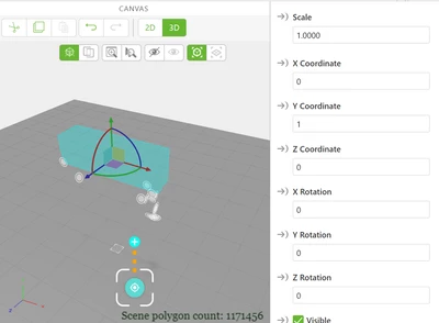

Hi all,

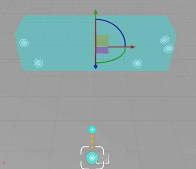

for me this issue is not related to the wayfinder widget. I tested it on a sample Vuforia Studio project (project attached if you want to verify my observations). All viewpoints are displayed  on the correct coordinates based on the root coordinate system. The positions property seems not to change when we change the model. But when the model have different offsets of the components  this will make the appearance of the waypoints as they are moved and are dislocated.
I checked a sample project which looks like this:
Where my first check to use a model with Wayfinder widget and then to  change the scale of the model and then to scale  the viewpoints coordinates .This was ok. Working fine.
Here the change of the display is based on the change of the model widget scale and then the zoom is called later to have better display
So it seems that when we scale the model and use the same factor to multiply the position of the viewpoints -> this will update the position correctly (refer to the attached project)
A second point  - what happens when we play a sequence which moves a component where we have an waypoint pointing to it. In this case we need to moved the viewpoint so that its position to corresponds to the changed position of the component:

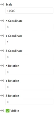

But I think there seems to be an issue when we change the model widget  - so there is some issue with scale factor of the model - so the scale of the model widget remains  unchanged but still   the model is scaled . At least I observed this behavior  when I  used different pvz files based on published Creo Illustrate  figure which refers to the same original model
So, tested - checked model widget scale is still =1 but switching between 3 models which used on base model and then switch back to them the scale factor attribute  was not  changed but displayed scale was wrong . When switching back then scale is still wrong. This is something I need to check more detailed if this occur only when we use different Illustration based on the same geometry or this is a general issue
Here I attached the test project if you want to check it by yourself. Thanks BR
