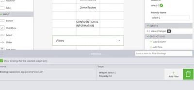

Hi, unfortunately, this solution didn't work.  I have checked the bindings but I can't see the issue.
Please advise/suggest a solution.

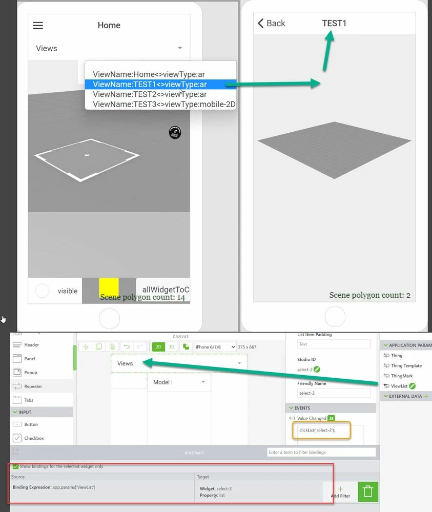

$scope.clickList= function(wdgName){
//this is the function for the click on the list to navigate to view
let view = $scope.getWidgetProp(wdgName,'value')
$scope.navigate(view)
So the mentioned functions will read the json file and create a list with the views and set it to a app parameter which could be linked to any list widget in any views. Here example for this :
Jun 29, 2023 9:33 AM UTC
Here attached the demo project where I tested this: DynModelChangeUIcommunity_new.zip
