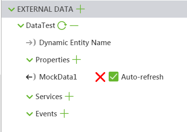

I have a thing created which feeds a live data feed into studio (just a python script i'm using for testing right now). I want to be able to access the value of this live data feed in javascript so I can manipulate it for several purposes (alter the text of a widget based on the data being between a certain range, apply math to the raw value to make it within a certain range, etc.).
I've been trying code like the following, which doesn't work:
$scope.app.mdl['DataTest'].svc['MockData1'];
$scope.app.mdl['DataTest'].data.current['MockData1'];
suggestions?

Paul WRIGHT​ The syntax that you wrote is correct. To retrieve the data/result of the service - "$scope.app.mdl['<thingname>'].svc['<servicename>'];" And the critical part is if the service returns the result in InfoTable format we need to convert that data into JSON format. Follow the below:
var temp = $scope.app.mdl['<thingname>'].svc['<servicename>'];
var tmpjson = angular.fromJson (temp);
To retrieve the values of the properties:  app.mdl['<thingname>'].properties['<prop-name>'];
