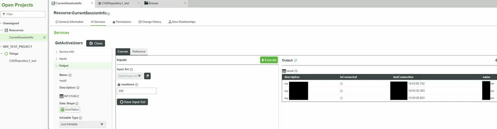

So to the other question who to receive you data from TWx service which returns an info table
- regitster the server to the Expternal data -also the properties of the service should allow access in Studio (please see  https://support.ptc.com/help/vuforia/studio/en/#page/Studio_Help_Center%2FGrantUserPermissions.htm and https://support.ptc.com/help/vuforia/studio/en/#page/Studio_Help_Center%2FAnonymousAccess.html%23)

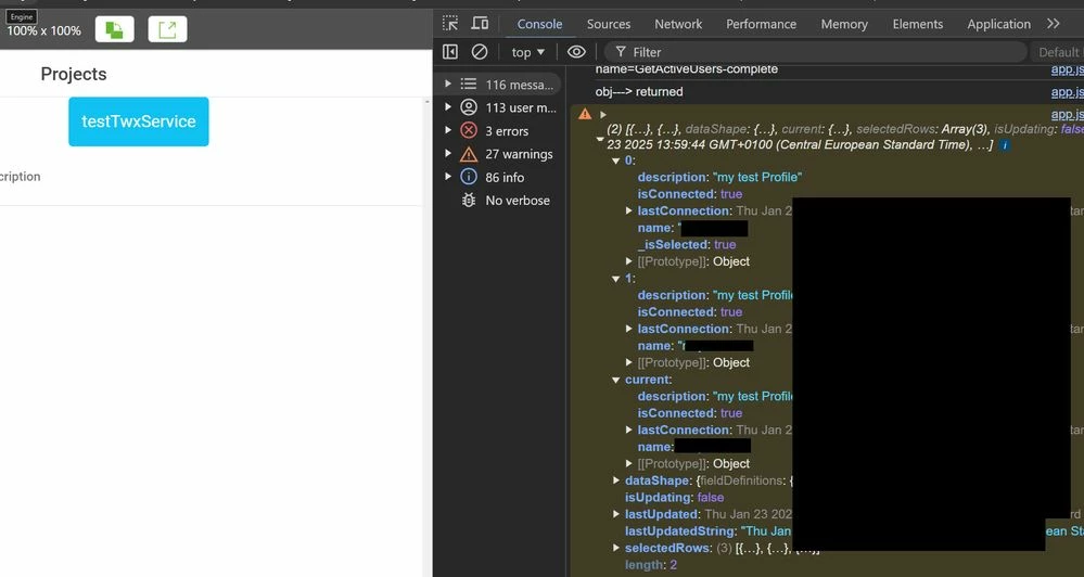

- then call the server - here example for the TWX statandard service  GetActiveUsers which returns an infoTable:
// this funciton will call the service data
$scope.testTwxService=function(){
 var TWXmodelID = 'CurrentSessionInfo';
 var serviceName = 'GetActiveUsers';
 var data = {};
 twx.app.fn.triggerDataService(TWXmodelID, serviceName, data);
// here we receive the data whe service call is completed
$scope.$root.$on('GetActiveUsers-complete', function(event, args) {
 console.log("GetActiveUsers-complete event");
 console.log("name="+event.name)
let retObjData= args.data;
console.log("obj---> returned")
console.warn(retObjData);//print the object in the console
$scope.retObjData=retObjData;
//at the end it will save the data in $scope.retObjData
so when we see the service :
will return a info table what we can see then in studio as objec like that:
accessing the returned fields required first to print the table and to staty the structure and then via the JSON array object syntax to acces the desried field what you want to have.
