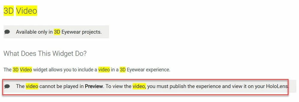

For the mobile devices you have first to  test your experience in preview. If it doesn’t work in preview it won’t work in View. But unfortunately for the HoloLens2 that does not work so according to help for the 3D Video Widget
So means that you need to test it on the device- HL2

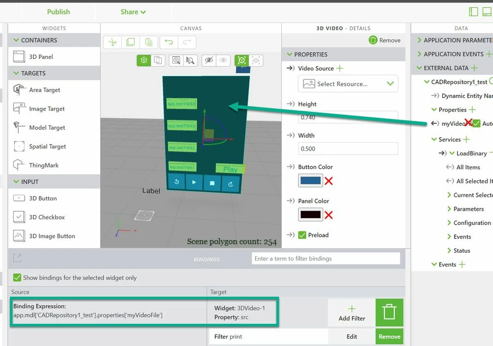

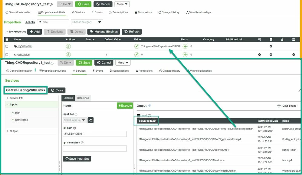

So for example I have a field in the repository myVideo as link :2024-11-06_18-57-12.jpg
so above the usage of the myVideoFile TWX property /type==HyperLink/ which is added in Vuforia Studio to the External Data section.
That property is defined here in the Repository where the data is uploaded.
 We can see that the value of the linkProperty has the syntax what is the output of the downloadLink field of the output /InfoTable/ of the GetFileListingWithLinks TWX service
Therefore I believe that you can use that syntax to set the resource property of the 3D video widget - e.g. some code like that :

I want to mention that that code will work only if the permissions for the access  of the repository thing are set correctly . Also the sample code is not really  perfect - it will try to start play with some delay after setting of the vidoe resource . ...But when the delay is not long enough  e.g. 2 seconds - so means in that time range the file is not loaded yet - then the play will be ignorred.
