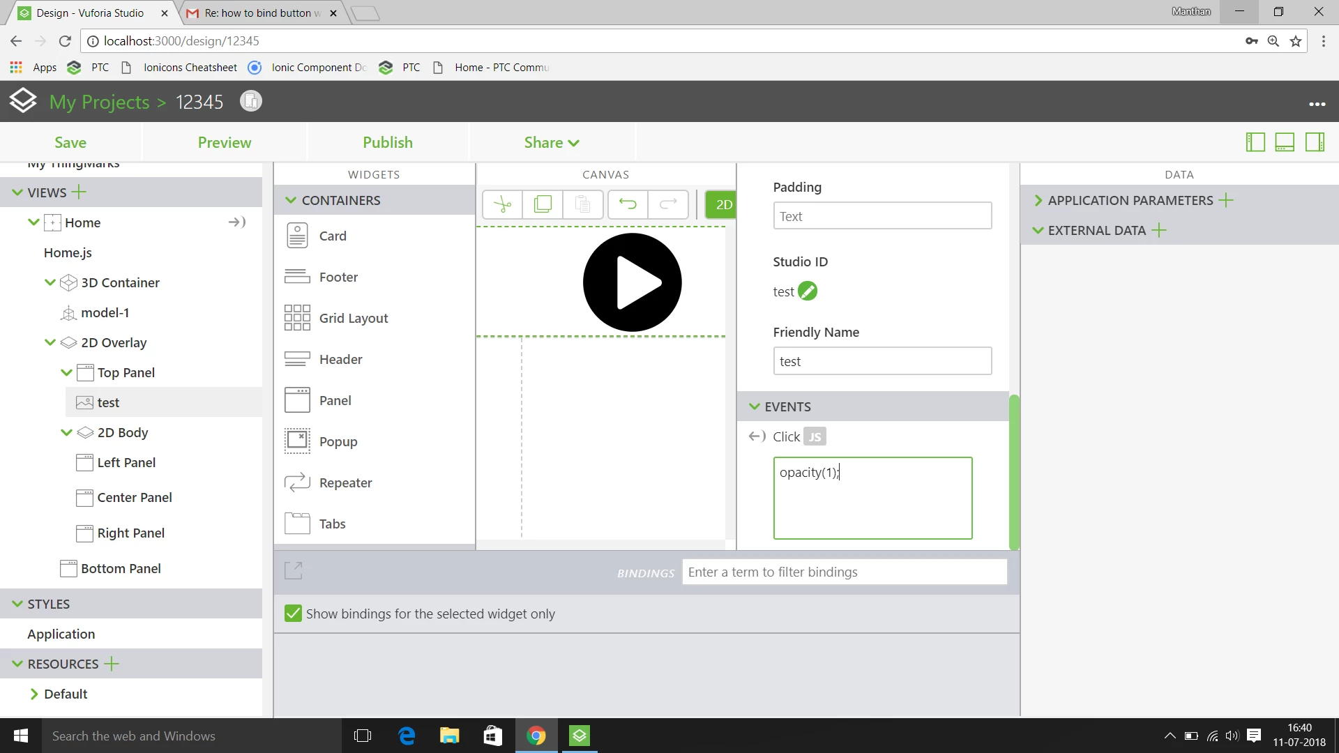

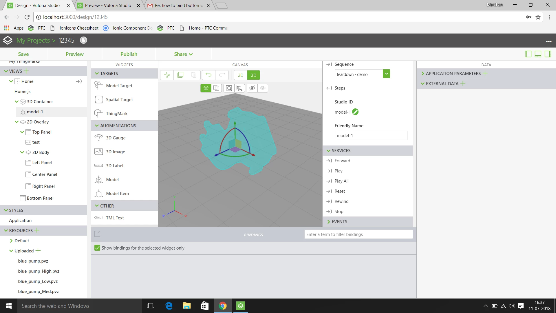

how to bind button with opacity?
How to bind button in such a way that when i click button the opacity of model will change to one?(Initially i set opacity to zero)

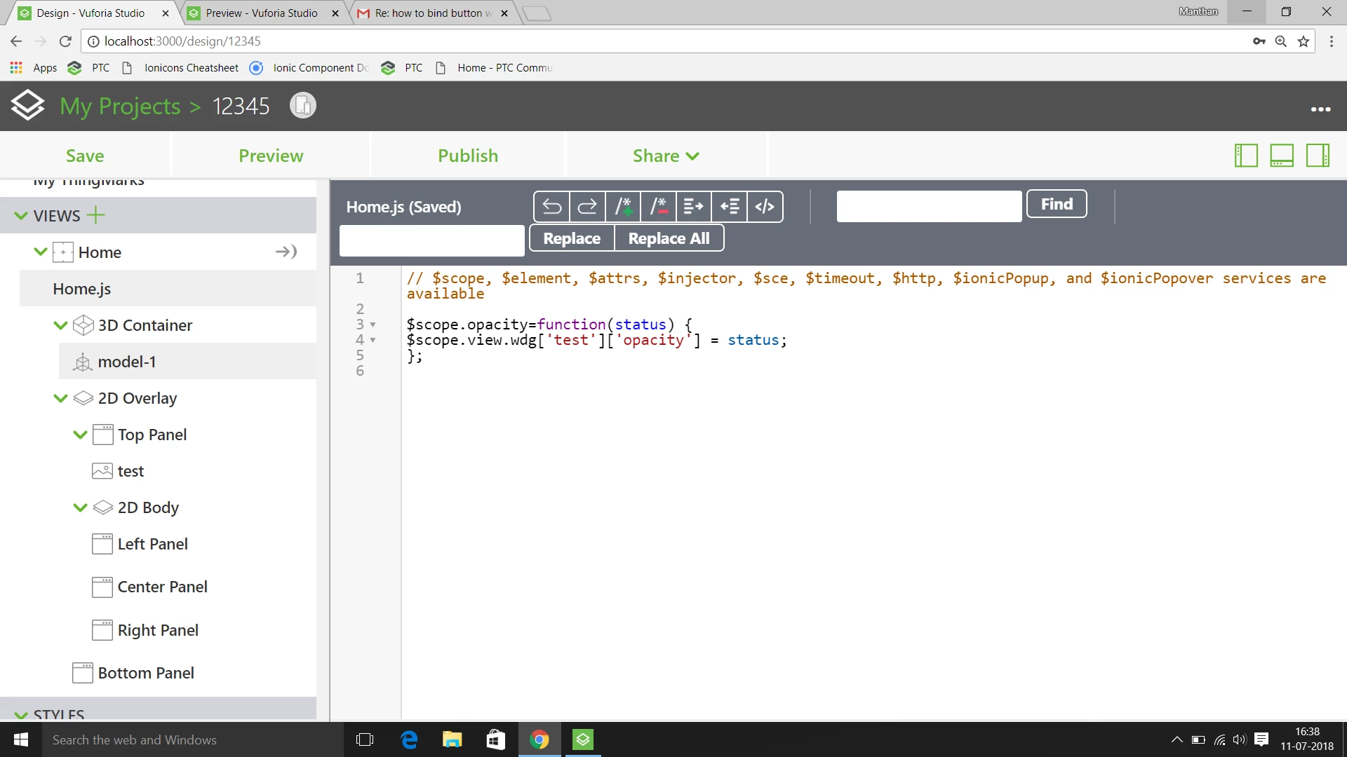

you can use this code Javascript:
$scope.opacity=function(status) {
$scope.view.wdg['IdObject']['opacity'] = status;
idObject as the id of the widget .
status is the value of opacity.
example :
if your widget has an id called    test   :
$scope.view.wdg['test']['opacity'] = status;
if you want  opacity 0
call    into  event of button    :    opacity(0)
if you want  opacity 1
call    into  event of button     :   opacity(1)

Hi @Giuseppe_Fiore
thank for your concern ... I have followed same steps but after clicking in preview it is not showing the model with opacity 1
Jul 11, 2018 12:02 PM UTC
you have wrong into the code...
change
with
 $scope.view.wdg['model-1']['opacity'] = status;
Bye
