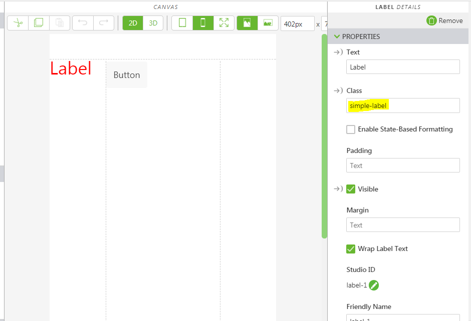

Hi Srinivas,
Please follow the below instructions to change font size and color for 2D label:
  • In the label properties, copy the class name. You can use the default class-name or define a new name. If you choose the default class-name, it will be applied to all the labels in the application. If you want to change the styles for only a specific label, then use the unique class name for that label.

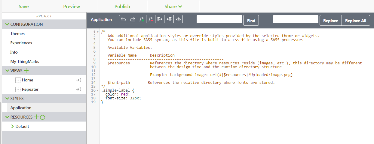

  • In the Project pain, expand the Styles option and Select Application.
  • This will open an editor view where you can enter the CSS code for your experience.

December 20, 2017
Thank you Yamini. 'STYLES>Application' worked. I even added font weight to make it look bold.
.simple-label {
  color: White;
  font-size: 14px;
  font-weight: 600;
Srinivas
