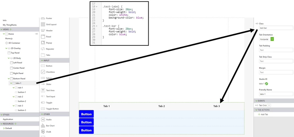

How to change tab background colour?
How can I change the background colour of a tab header? (Tab 1, Tab 2, Tab 3 in the image)
'color' has no effect and 'background-color' changes the background of the Tab contents below, not the Tab header.
lghermanAnswer

Hello rhudd,
Try setting the Tab Strip Class instead of the Class field.
Kind regards,
Lorena

rhudd10-MarbleAuthor
Feb 21, 2020 3:14 PM UTC
😐...sometimes I'm not a smart man 😂
That's fixed it, thank you!
