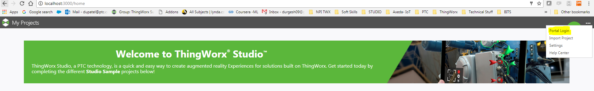

please help me to connect experience service URL in thingworx studio

Nirav Patel​: You can configure going to Studio URL then clicking 3 dot option -> Portal login as shown below.  Enter your portal credential to auto configure. On successful configuration, system will Identify your Experience Service (ES) automatically.
Once done, you can check configuration using the other option Settings. There you should see your Default ES URL populated upon successful auto configuration as advised.
