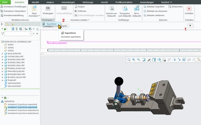

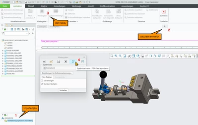

  • how to export FRA files:

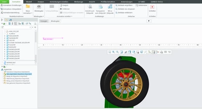

    in animation, you would use → mwodarz_INNEO_0-1767943227353.png or mwodarz_INNEO_3-1767944355497.png

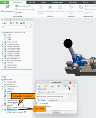

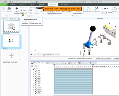

The screenshots were created in Creo Parametric 9 and Illustrate 12.1 with a german UI (on purpose. The english UI uses the same icons 😉 )
