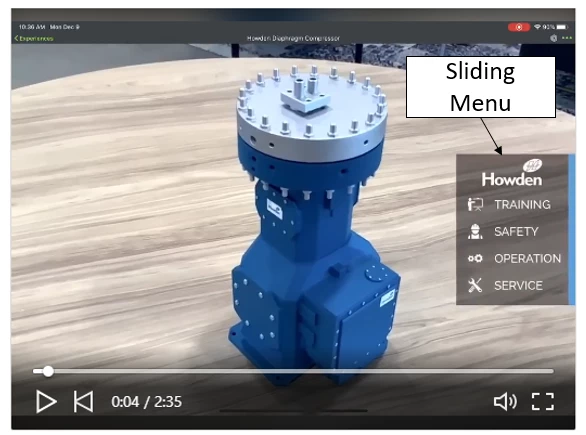

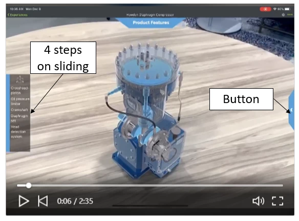

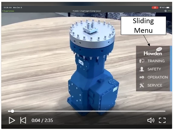

I want to learn how to create the sliding buttons as there in the image also how the sequence steps have been created oppo

Hello manojpandey
for sliding panels I am using a CSS:
.panel-hide {
 position: fixed;
 right: -300px;
 top: 0;
 width: 300px;
 height: 100vh
.panel-show {
 position: fixed;
 right: 0;
 top: 0;
 width: 300px;
 height: 100vh
Then it is up to you how you assign these styles via JS. You can for example call a function under  Play button (or in "Play Started" event under model) which will check step number for displaying/changing a specific widgets - for example simple way via switch:
$scope.setStepWdgs = function() {
 var step = $scope.view.wdg['model-1']['currentStep'];
 switch(step) {
 case 4:
 // Display panel on start of step #4:
 $scope.view.wdg['panel-1']['class'] = "panel-show";
 break;
 case 5:
 // Hide panel on start of step #5:
 $scope.view.wdg['panel-1']['class'] = "panel-hide";
 break;
 default:
 /*some code for common steps*/
Tomas
PS: This code is only example I didn't try it 😅

These have most likely been done using CSS animations to animate out the panels.  I've used something similar in the past, but really it was just a test to see how it worked.  It's all explained at W3 schools: https://www.w3schools.com/css/css3_animations.asp
Hope this helps.

Did you make 2 similar panel widgets for sliding it and giving them different classes? How did you trigger the sliding of panels by js?
