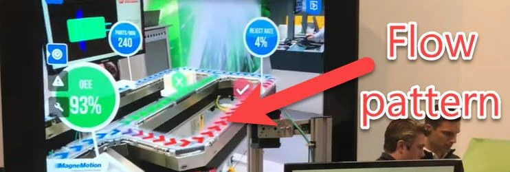

How to create the flow pattern on the conveyor with Vuforia studio same as PTC Demo ?

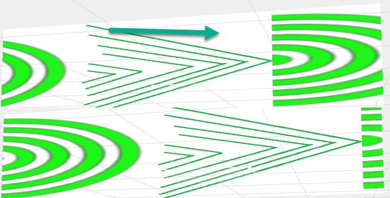

Hi @kasem ,
such flow pattern could be done by shader which move a texture along a direction. You can define shader with GLSL This is a general functionality which is not PTC specific and is used for some customizations inside the TML text widget. In the TML Text widget you can add a GLSL shader definition code and then use it in Studio for some widget  where you can set the shader property. But as already mention GLSL is a general WebGl functionality. The used shader is probably designed by PTC  Presales team and is not generally  made public so that I do not have information about the particular implementation (shown there in your  picture)
You can contact PTC sales or consulting team and ask for the implantation / or to request  such implementation
Otherwise you can study the GLSL and create this by your own (you can check in the web. for GLSL e.g. https://de.wikipedia.org/wiki/OpenGL_Shading_Language or https://developer.mozilla.org/en-US/docs/Games/Techniques/3D_on_the_web/GLSL_Shaders)
Here is a simple example of simple  shader on a 3d Image widget . The shader  will move a texture along a x (negative):
