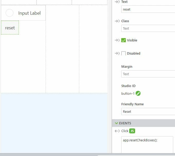

2.) regarding to the quesiton how to uncheck and enable all checkboxes -you could start form the restet button some code like this:
$scope.app.resetCheckBoxes=function()
 wdgs=$scope.view.wdg
Object.keys(wdgs).forEach(function(key) {
 wdg = wdgs[key]
 console.warn(wdg)
 if ( wdg.widgetName.indexOf('checkbox') !=-1) {
 $scope.view.wdg[key]['value']=false;
	 $scope.view.wdg[key]['disabled']=false;
 $scope.$applyAsync();}})
and call the app.resetCheckBoxes(); from the UI Javascript box of Reset button
 wdg = wdgs[key]
 console.warn(wdg)
