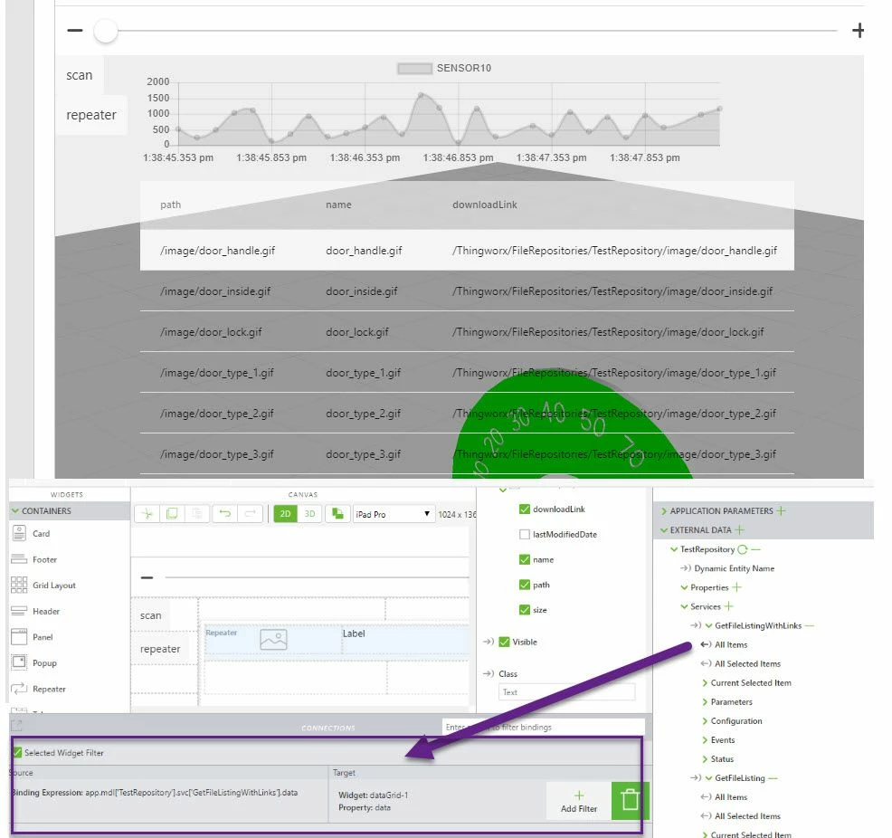

Hi all,
I have a Thingworx service with output field datatype as 'ImageLink'. When I map output data to 'dataGrid' in vuforia studio, I'm only getting Image entity name in Vuforia preview (PFB PNG for Reference)
Could any one help me to solve this.
Thanks in advance.
/VR

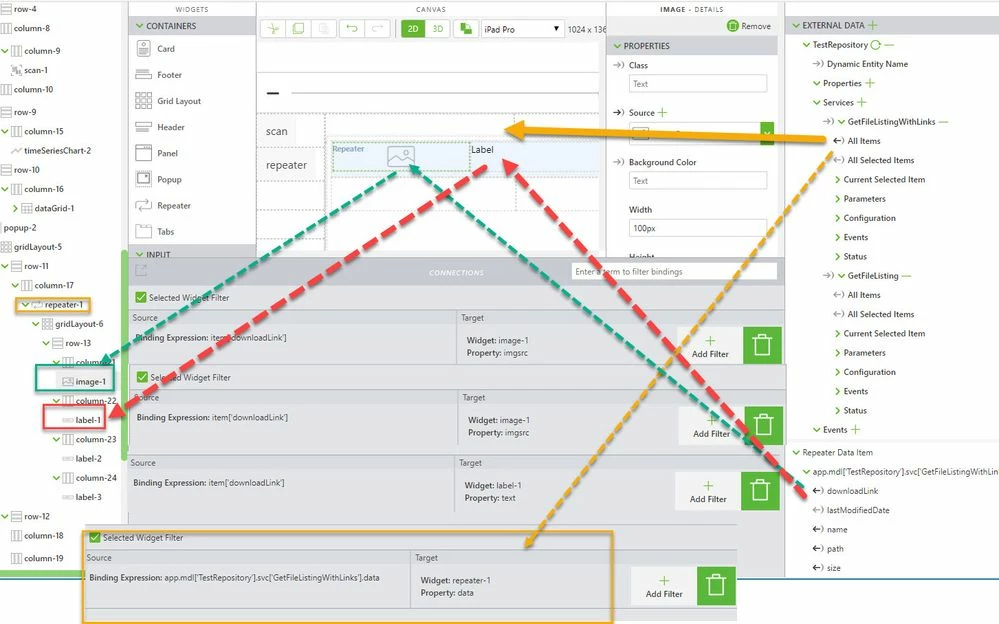

Best answer by RolandRaytchev
Hi @Velkumar ,
this could be done with repeater widget + grid layout in it with columns. In which column we have to add a widget for the item display. e.g. label for text display or e.g. Image widget for image display ... etc.
 when I use the GetFileWithLinks service of a Repository thing and link it to a dataGrid widget. This will make it automatik display but all fields are displayed as text:
The link are also displayed as   text.

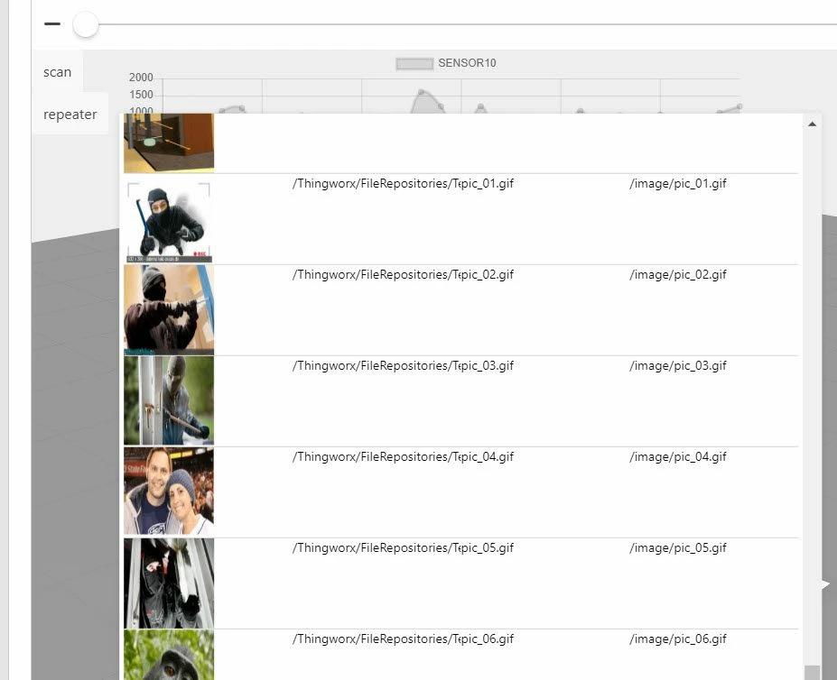

In a repeater you can also link a source property to the link and in this case it will display the  link as picture /if it is a real  picture:
In the repeater the same service is used : GetFileListingWithLinks . All Items are linked to the repeater data property:
We can  see when we create binding of the link to the source property of a image it will display it and if we link to the text property of a label it will display the link as text
